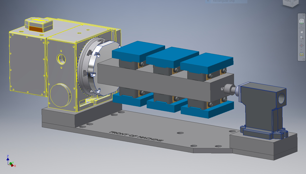

See if this helps any… There are 6 (six) D362 5th Axis dovetail blocks on this fixture, holding the material. This is on a HRT210 rotary, so just a couple inches bigger…
I can also take them off and use them on other fixtures, or as a clamping fixture if we get a “5th axis” on our machines. They have different sizes too depending on your work piece, but I’m guessing you’ve already looked into that. :slight_smile:

This is what I would do exactly right here. find some Cad Designs like this and show your boss. You can’t get a better understanding than visual confirmation. Check GrabCad and other free sites for 3D Models download them or save picture. I think this would be the best way to get your boss on board with making change for the better of the company. I have used 3D Models and also wrote up a single page breakdown of how I see the Company growth going and what all it would open up capabilities wise for the Company. When you break it down and give them everything on a Platter so they can go to their Boss and take credit “IT Helps”.

The HRT160 has a 5" centerline, the Mini Mill has 10" travel in Z. This will limit you if you have any tools that have any length at all. It would not take much time to have a 1st op that makes a dovetail in bottom of material, the benefits of superior clamping force will allow you to take faster cuts with less vibration and chatter. You could make you own dovetail clamp vise.
Stephen has a valid point a dovetail setup to a regular vise would give superior clamping force since you don’t have a lot of Z travel
