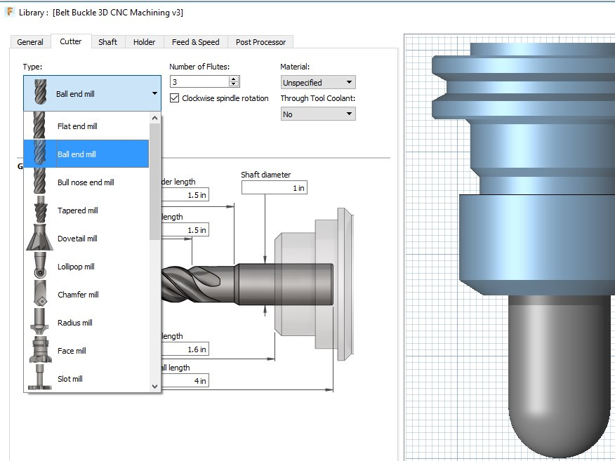

Here is the drop down menu for ball nose end mills and the choices you can make

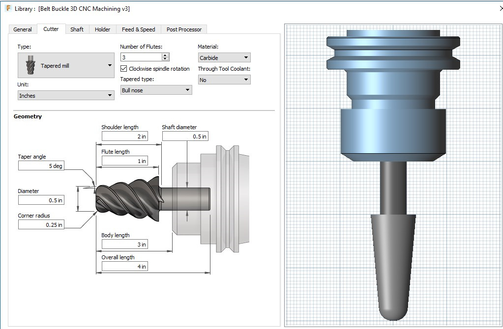

Here is my attempt to make a taper barrel cutter

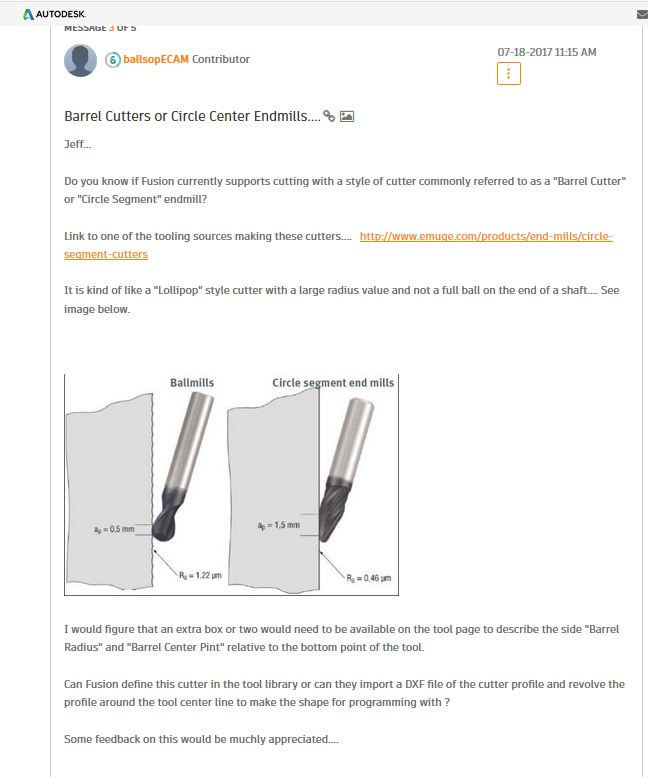

I have book marked a topic in the AutoDesk forum seeking the same question you have posed… Hopefully they will provide a definitive answer.
It appears it is on AutoDesk’s idea station, but not yet supported. I believe the HyperMill software will support the 5-axis solution using barrel cutters.
https://forums.autodesk.com/t5/hsm-ideas/support-barrel-cutters-and-conical-ball-cutters-in-5-axis/idi-p/7155966
