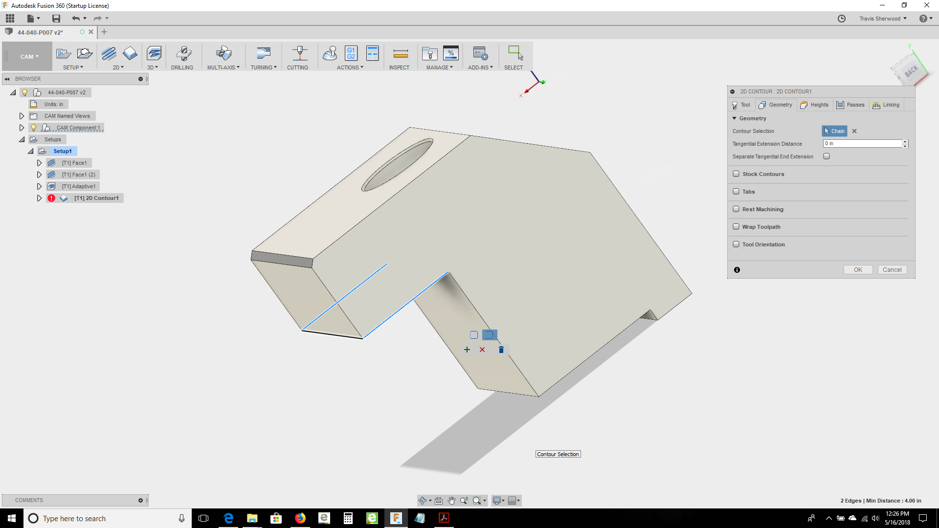

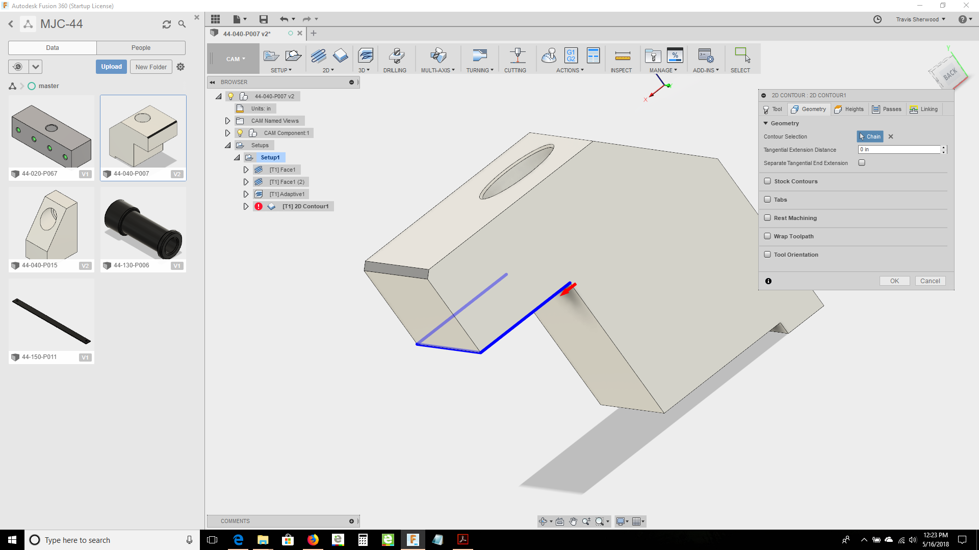

I am having an issue with getting this part to only cut the end.
I clicked on the selected Chain and it will not let go of the two lines in the X axis.
I am using 2d contour.

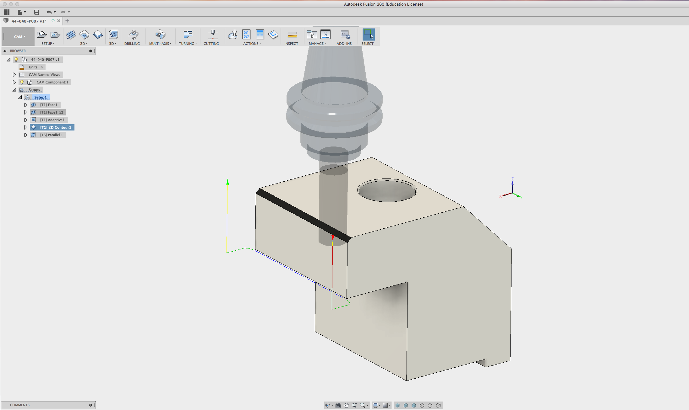

@Rumpelstiltskin Make the end line blue and unselect the other 2 blue lines. Set as open contour and click accept button

Press alt when selecting and should be able to select a single line. Alternatively click the contour then click the blue line again. A new menu pops up. Select open contour and select the lines you need then click the plus sign to add. Hope this helps.

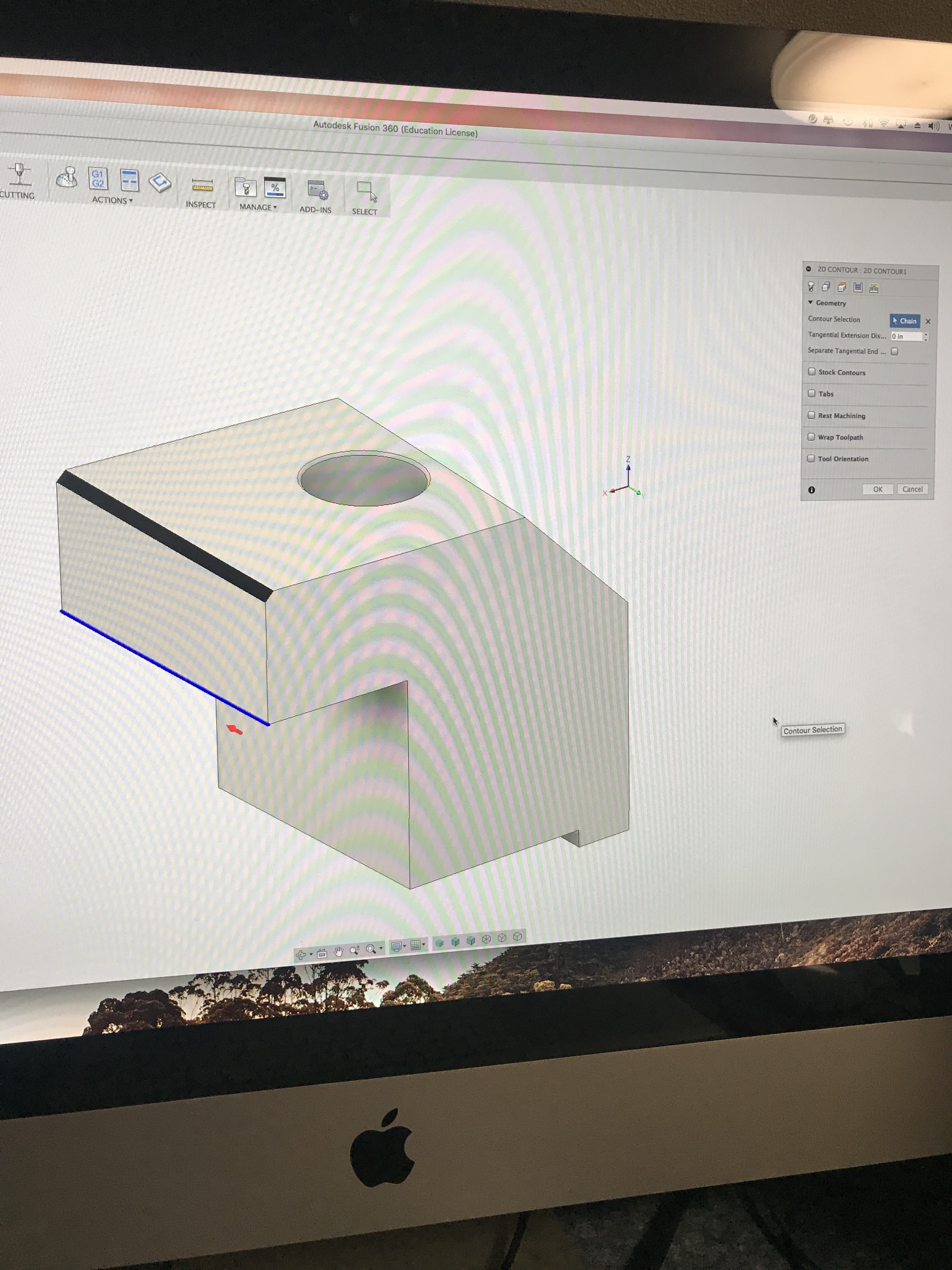

Very late reply, but hold the alt key or the apple version down when selecting the toolpath, this forces it to only pick one segment.
