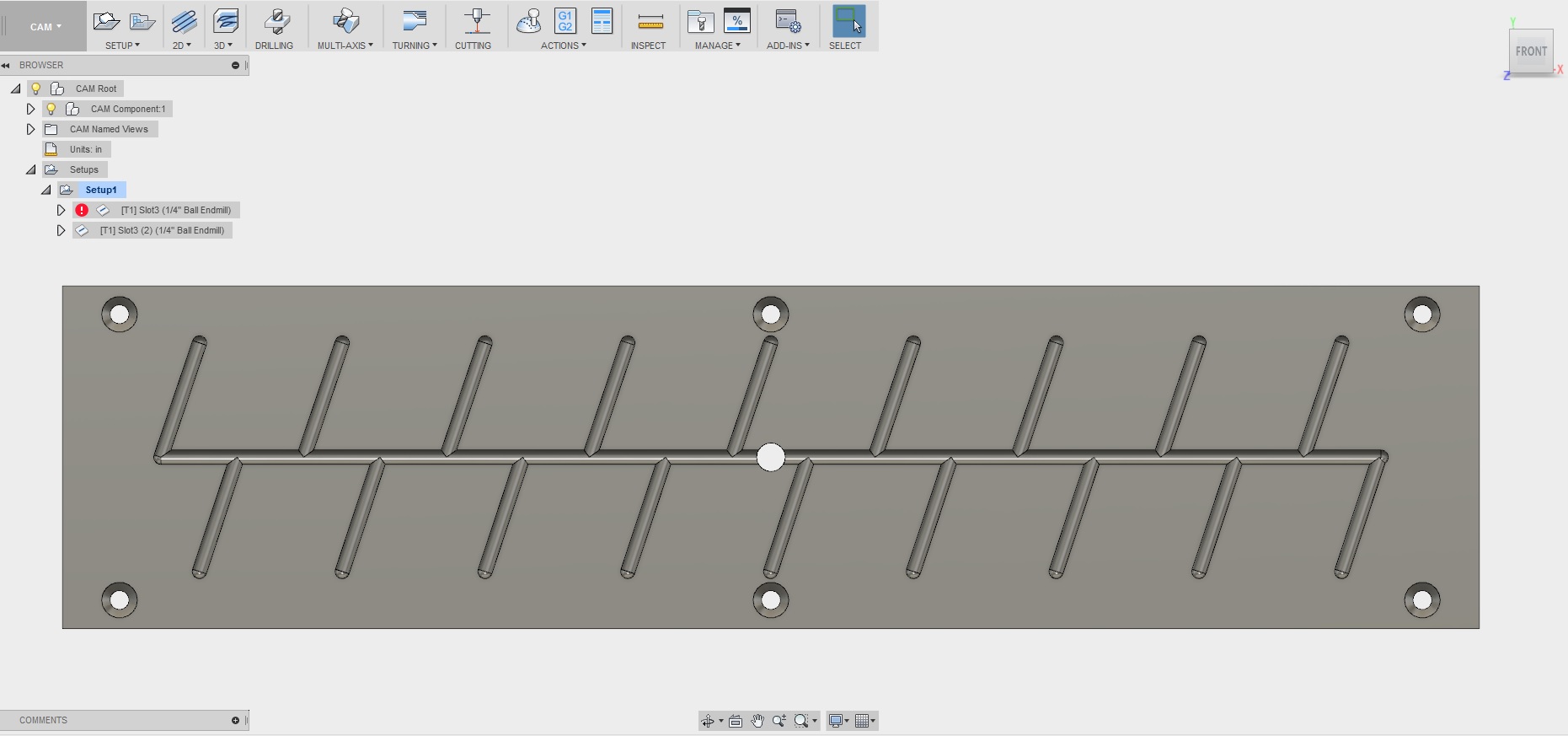

I’m looking for a little help with a part we have. It’s a flat plate with a radius slot down the center and intersecting slots. (grease slots on a wear plate) The part came in as a STP file, I can get the intersecting slots to run using the “slot” mill 2D but I haven’t been able to get the center slot to run because of the intersects, either open or closed profile. I’m using a 1/4 ballnose, the slots are full rad. If anyone has any ideas or knows the way to get this programed, I’d really appreciate the help! :slight_smile:

Quick and dirty just sketch the center line on the surface in CAD and adjust the z in CAM ? Select the line for your tool path.
Awesome! I figured it would be something stupid easy.
Thanks!!
