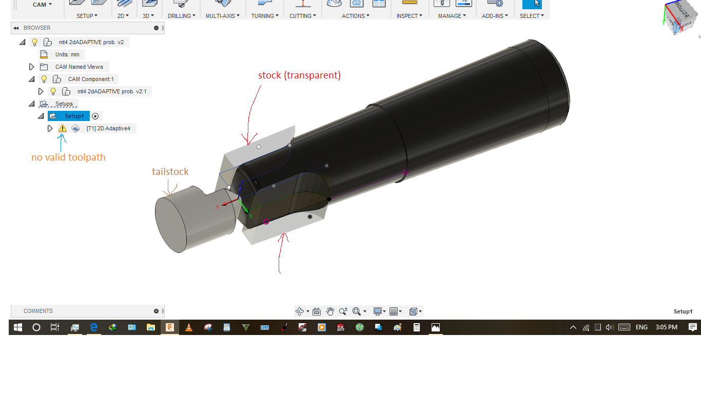

Hi Friends,
I’m learning CAM using Fusion 360. I’m trying to rough the stock using 2D Adaptive clearing with a 16mm flat end mill. But Fusion keeps telling me that there is no valid toolpath from my configurations. I tried altering the passes, linking, geometry but unable to find where I’m making mistake. File link https://a360.co/2KYNY7m (file updated with 2D Adaptive)

Try changing the ramp. I find a lot of empty tool path are because the ramp strategy needs to be changed.
Tried it but didn’t work.
I wouldn’t use 2D adaptive. You created a closed contour and the tool is too big to machine that feature as constrained. I changed to a 2D contour, multiple depths, with finish pass. You have to press the alt key when you select your geometry, if you use the geometry that you created your stock body.

Worked like charm. I’ve used 2D Adaptive with multiple stepover for max tool contact. Thank you sir.
