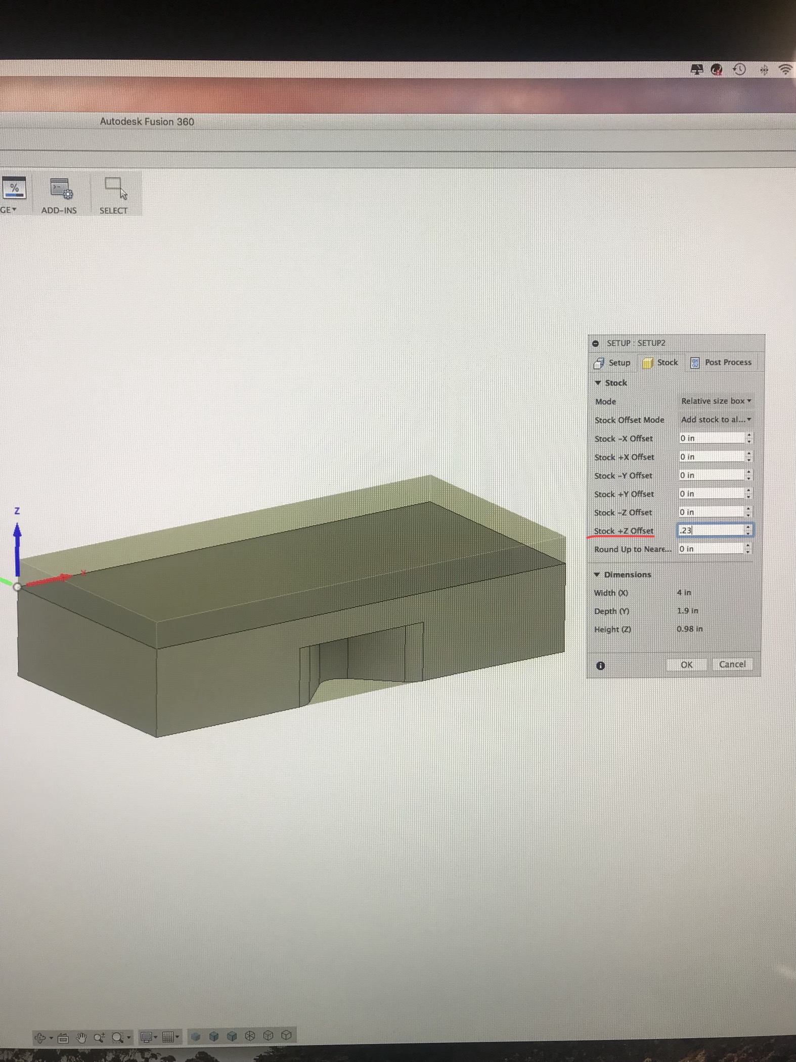

@NathanCobb. Set your WCS as Model Top. Did you face off .020 at the beginning of the part? If so you will have .230 stock left on the bottom. I attached a picture showing the .230 stock on the bottom which is now the top of the part for Second Operation. You will have to offset your Z height .230 if you set WCS Origin as Model Box Point.

I still have Model Top but put Feed height at .23
And then do multiple Z passes at .1125 with a .005 finish pass
