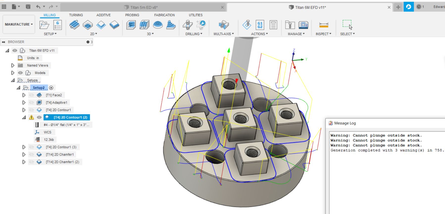

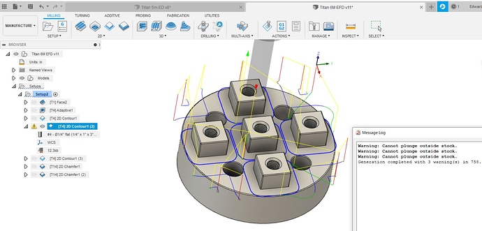

Warning: Cannot plunge outside stock
Warning: Cannot plunge outside stock - I keep on getting these randon yellows alerts
After Fusion updated the last time I am getting the same error and can’t get rid of it

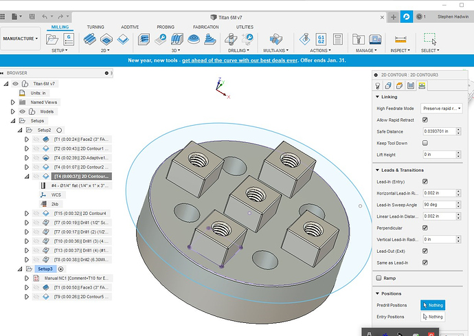

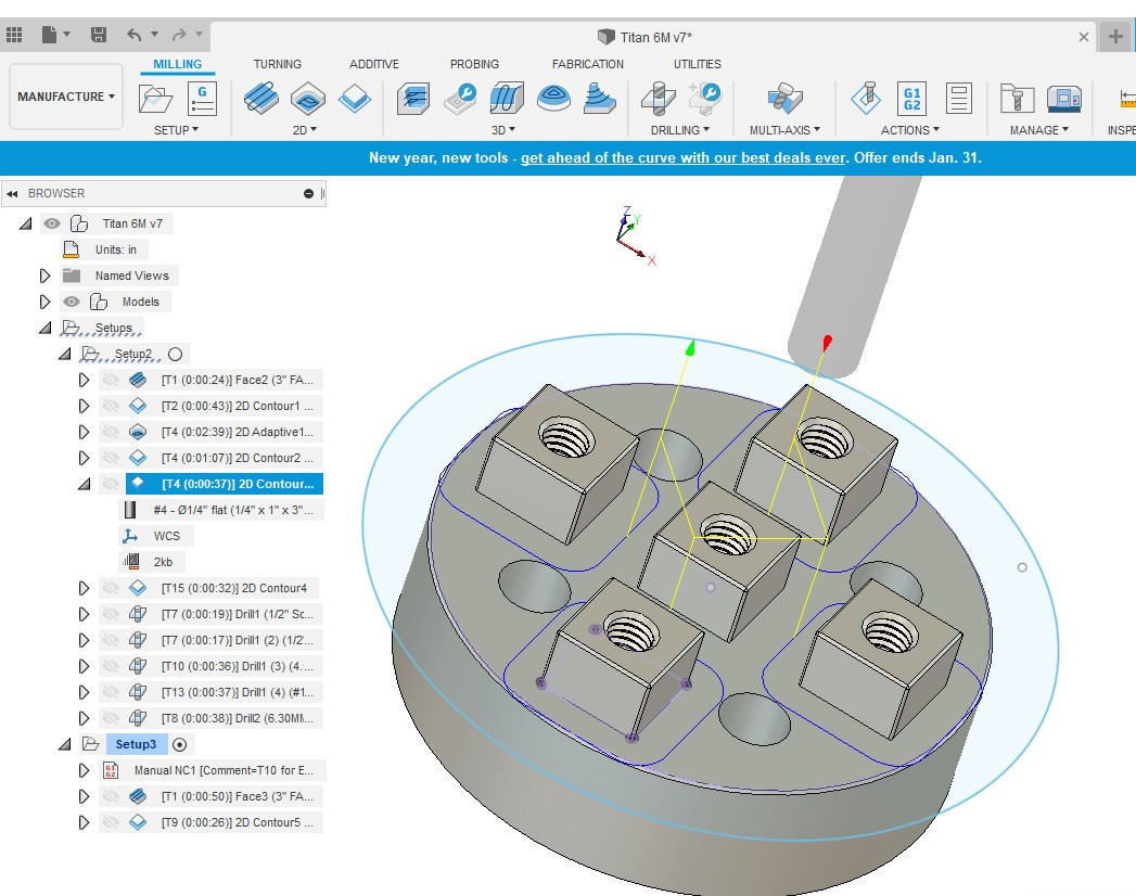

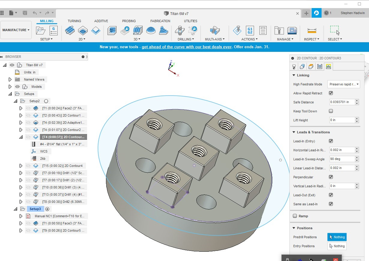

I had my students contour the inner square separately and then a separate contour for the 4 outside squares.

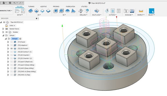

I think it may be better as a pocket routine with islands? I think the roughing/multi passes are the problem that makes this alert come on.
Yes, @markpesce, you ran the adaptive, that should have roughed out the material around the squares. You need to turn off off the roughing pass. I would also eliminate the vertical lead in radius (make it zero) and shorten the lead in/out. I finished passed the internal square first, found it not working like I wanted when I tried to contour all 5 squares at one time.
I tried a Pocket routine - I had to sketch a big circle to use as outer boundary and it also ramped around center
